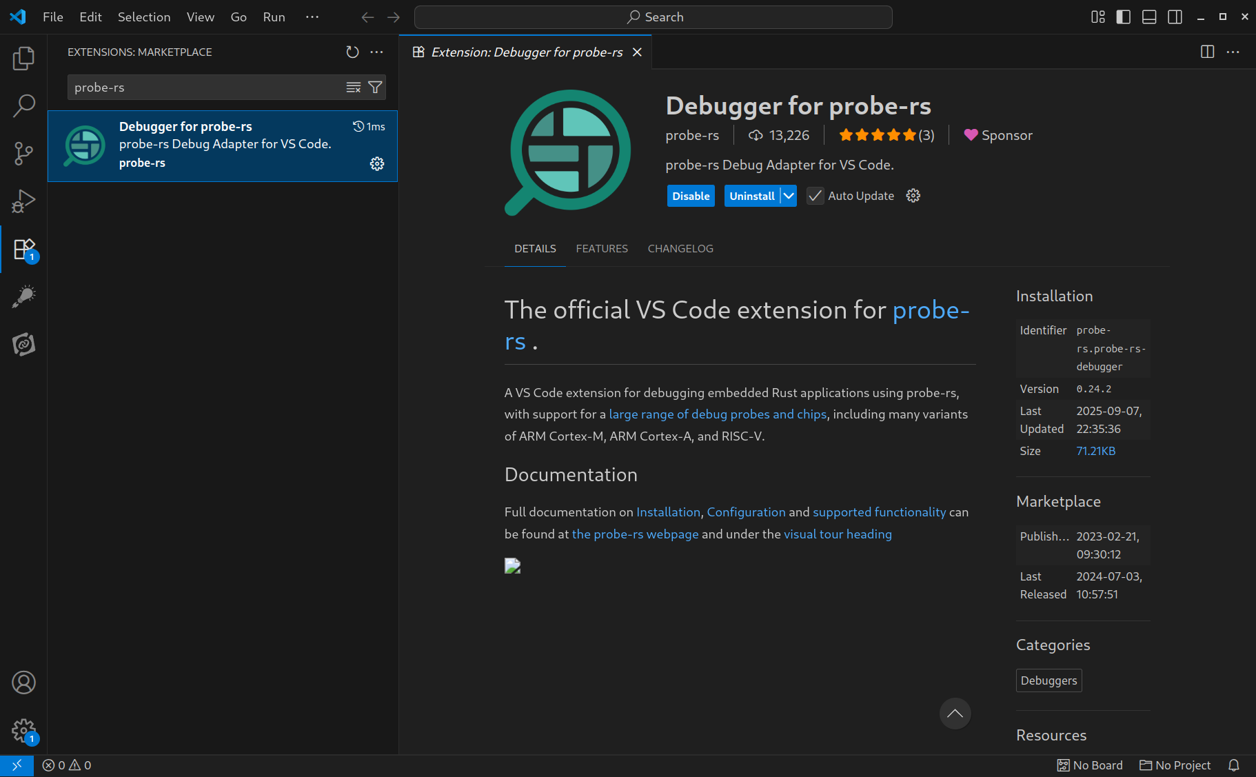

1. Install the probe-rs Debugger Extension
Start by installing the “Debugger for probe-rs” extension directly from the VS Code Marketplace. This tool bridges probe-rs and VS Code’s built-in debugging system, making stepping through firmware straightforward.

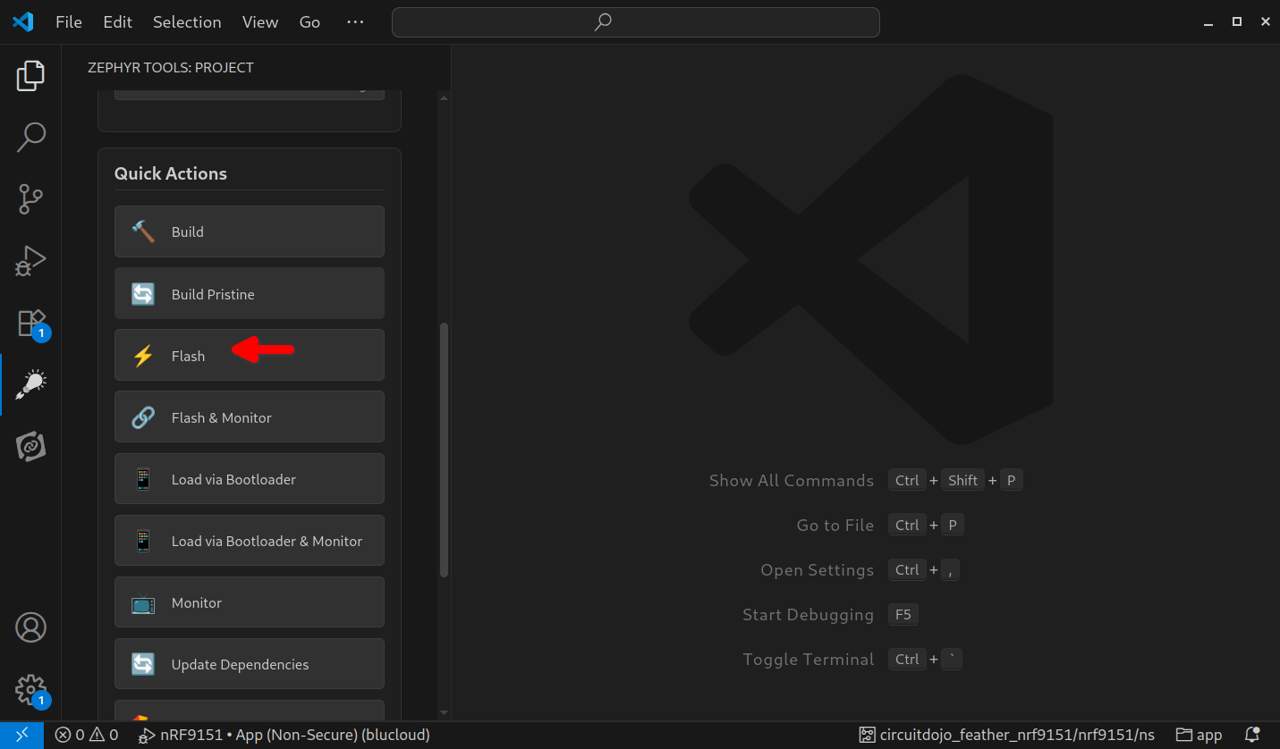

3. Flash Your Firmware & Begin
With your code built, it’s time to upload — use the “Flash” option in Circuit Dojo Zephyr Tools to program the merged.hex file onto the device. After flashing, the Monitor button lets you view console output in real time.

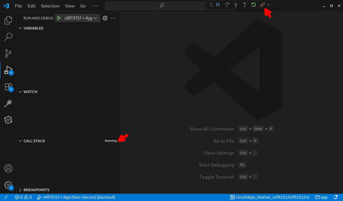

5. Confirm Debugging Is Active
Once connected, you’ll notice:
  • A “Running” status in the VS Code Debug pane
  • A prominent red disconnect button next to the debugger controls
If you see these, you’re in business — you can now set breakpoints, inspect variables, and step through your firmware effortlessly.
