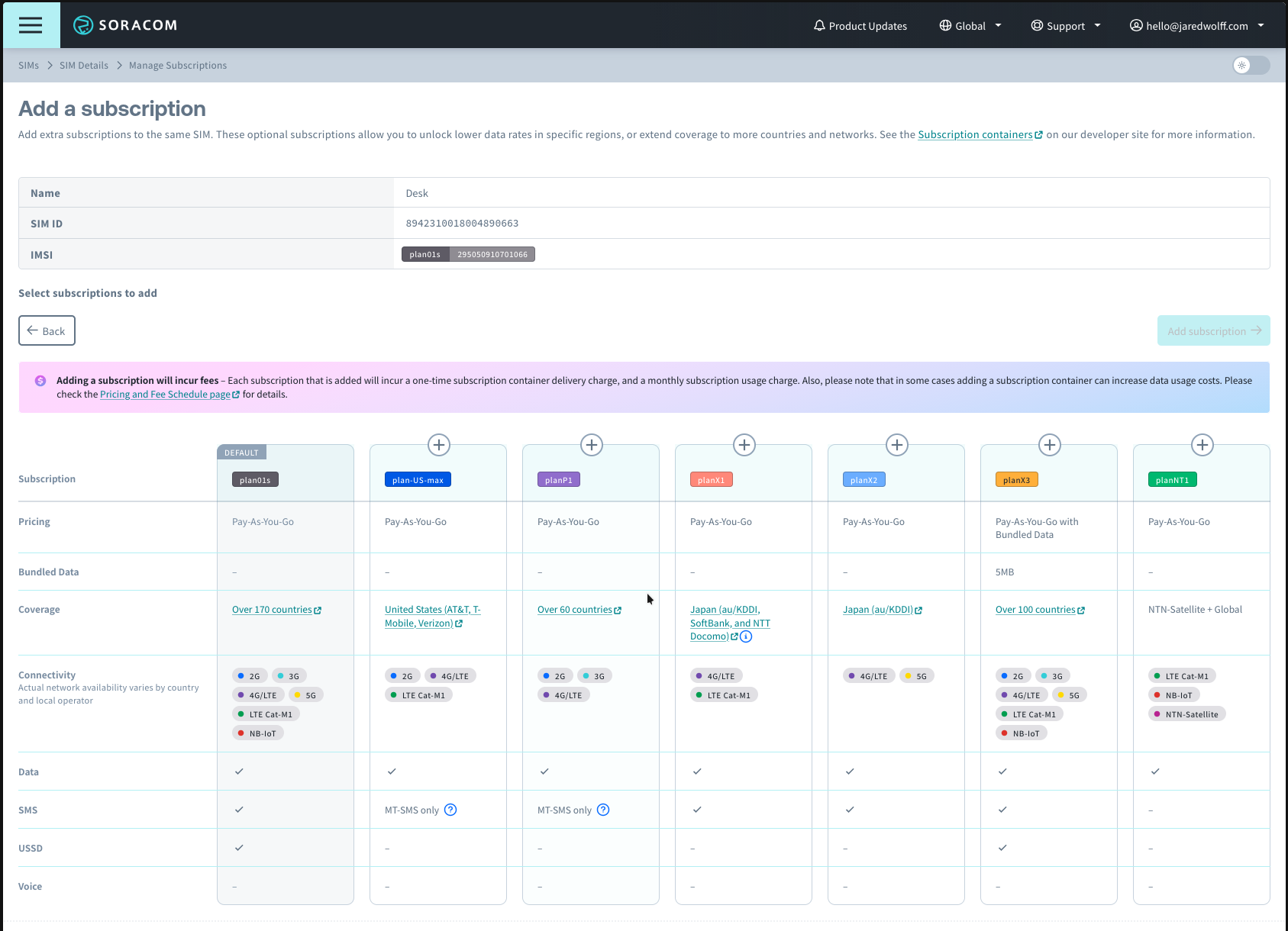

Soracom makes basic SIM activation easy — the NTN part takes a little more care. In the Soracom console, open your SIM and add a subscription: planNT1 (coverage: NTN-Satellite + Global).
Soracom add-a-subscription screen — planNT1 is the rightmost column

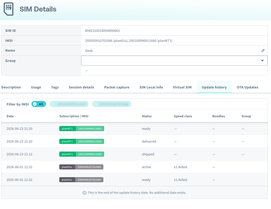

Once subscribed, the SIM carries two IMSIs — one for your original plan and one for planNT1. Only one is active at a time, and switching between them is done from the device with AT commands.
Here’s the part everyone gets stuck on: the planNT1 subscription must first be delivered to the SIM over a regular terrestrial connection. Let the device attach via CAT-M as usual and watch the Soracom console — the plan moves from Shipped to Delivered to Ready. Until it reads Ready, the NTN IMSI isn’t on the card and the switch commands will get you nowhere.

Soracom SIM update history showing planNT1 moving to ready
