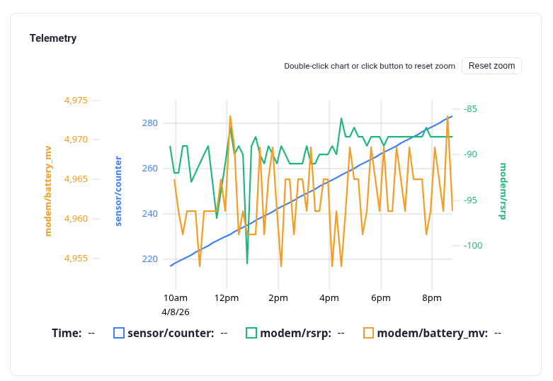

Lion telemetry chart for a single device

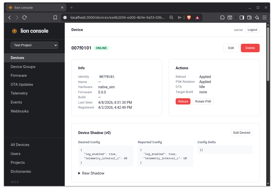

Device Shadow as the Source of Truth
I borrowed the device shadow idea from AWS. A shadow is a JSON document representing the device’s state, shared between server and device. The device pushes updates to its half; the server pushes updates to the desired half; they reconcile.
I like it because it gives you one mental model for everything: state, configuration, and — here’s the part with a twist — commands.
Lion device detail page showing shadow, actions, and info
Commands live inside the shadow
The conventional approach to “send a command to a device” is to build a queue. Pending commands sit somewhere, the device pulls them, ack’d ones get cleared. That’s a bunch of infrastructure for what’s really a simple problem.
Lion puts commands directly in the shadow with a generation counter. To reboot a device, the server bumps the reboot counter from 9 to 10. The device sees the new value on its next sync, runs the command, and stores 10 as the last-acted generation.
I’ll be honest: when I first saw AWS doing this, I thought it was silly. Why am I incrementing a number? It only clicked when I ran into the problem myself. The counter is the indicator. No queue infrastructure required, no “is this command stale” logic, no separate ack path. The shadow is already the thing being synced — let it carry commands too.

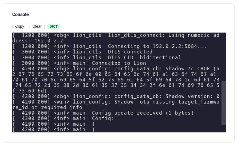

Sending Zephyr LOG_INF() output over cellular sounds prohibitively expensive — and it is, if you send the strings. A handful of verbose logs per minute, multiplied across a fleet, will eat your data budget alive.
Zephyr has a built-in dictionary mode for logging that solves this. At compile time it extracts all your log strings into a dictionary file. At runtime, the device sends only short tokens — basically “log line 1, log line 2, log line 3” — and the host side expands them back into the human-readable strings using the dictionary.
If you’ve used defmt from Ferrous Systems / Knurling, this is the same concept they apply to RTT/SWD-based logging in embedded Rust. They use it to push way more log volume over the wire than would otherwise fit. Lion uses the same idea, but over CoAP/DTLS instead of SWD.
The result: I can leave logging on for fielded devices and actually get useful diagnostics back without dreading the data bill. I’ve personally been on the wrong side of “the device is failing in the field, can you send me logs?” too many times. Now I can.
The dashboard expands the dictionary on the server side and shows you the readable log stream. The device just sends bytes.
Lion console showing dictionary-decoded log stream from a device
