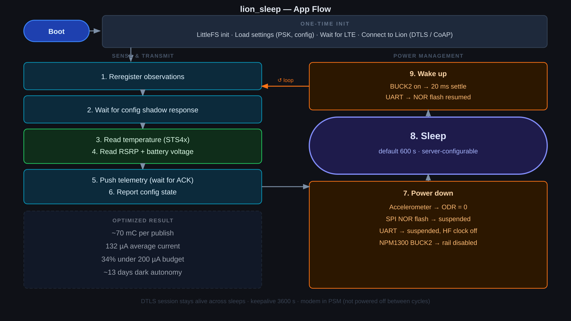

The application: lion_sleep
The firmware is a straightforward low-power loop built on Lion IoT — a CoAP/DTLS backend designed for exactly this kind of always-connected, low-power deployment:
Boot
 ├─ LittleFS init (NOR flash)
 ├─ Settings load (persisted PSK, config)
 ├─ Wait for LTE
 ├─ Connect to Lion IoT (DTLS bootstrap + CoAP)
 └─ Loop forever:
     1. lion_client_reregister_observations()
     2. Wait for config shadow response
     3. Read STS40 temperature
     4. Read modem RSRP + battery voltage
     5. Push telemetry (wait for ACK)
     6. Report config state
     7. Disable peripherals (NOR, UART, BUCK2)
     8. k_sleep(telemetry_interval_s)    ← default 600 s
     9. Resume peripherals
    10. goto 1
lion_sleep app flow diagram
The device sends three values every cycle: RSRP (signal quality), temperature from the onboard STS40, and battery voltage via the modem ADC. The telemetry interval is server-controlled — change it in the Lion dashboard and the device picks it up next cycle.

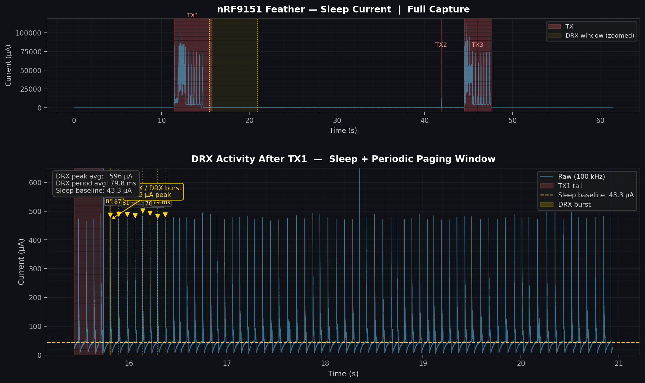

The eDRX trap
After the PSM work everything looked great — under 5 µA sleeping, about 80 mC per publish, clean current profile. Then during extra restart testing, after the third or fourth reconnect cycle, 500 µA pulses appeared every ~80 ms.
These pulses came from eDRX. eDRX is a paging optimization for always-on devices: the modem negotiates a listen window with the tower, sleeps between windows, and wakes briefly to check for downlink data. That’s useful if you’re waiting for a server push. It’s counterproductive if you’re doing a deep application-level sleep where the modem is already going to PSM — the eDRX wake cycles keep firing anyway until the modem firmware times out, which on short publish intervals means they stay active the entire time.
Removing the CONFIG_LTE_EDRX_REQ=y entry (eDRX is off by default) eliminated the pulses immediately.
PPK2 capture showing eDRX burst activity after TX1

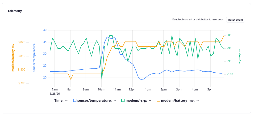

The bonus: free irradiance data
One side effect of logging supercap voltage every cycle: you can see exactly when the sun hits the panel. In the test deployment, voltage jumps sharply to 3.8 V around 10 AM and the rate of rise through the morning gives a rough sense of cloud cover. It’s a crude ambient light sensor for free, as long as you’re already logging battery voltage.
Lion dashboard showing temperature, RSRP, and supercap voltage over the day

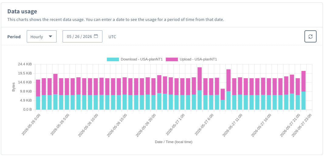

Reconnect scenario (Soracom hourly, ~15–20 KiB/hr):
Soracom data usage — reconnect every cycle

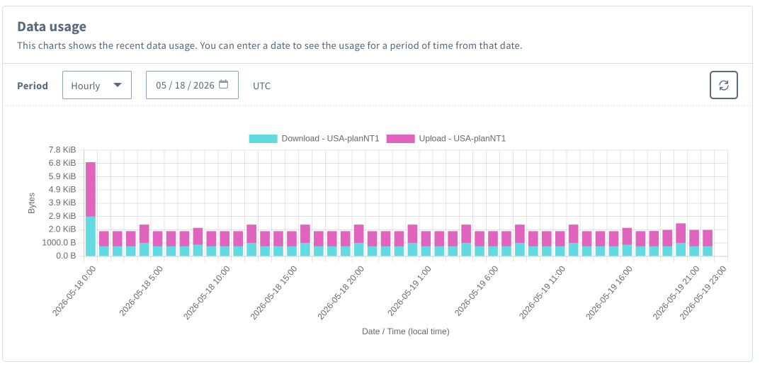

Optimized PSM scenario (same SIM plan, ~1–2 KiB/hr):
Soracom data usage — always-open PSM
